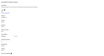

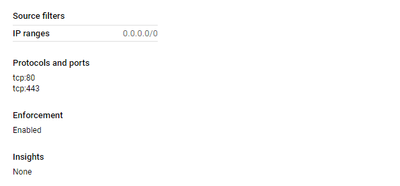

Network Configuration: Custom VPC
  • Firewall Rule:
    • Your custom VPC firewall rule seems to be set to allow all incoming traffic (0.0.0.0/0) on all protocols and ports. This should theoretically include port 443.
    • Double-check that this firewall rule is associated with the network your VM is in and that the VM has the correct network tags to match this rule.
  • Priority: The priority of 65534 is very low, which is fine as long as there are no conflicting rules with higher priority that might override this one.

  1. Recheck External Firewall Rules:
    • Ensure your Google Cloud Platform (GCP) firewall rules are correctly configured to allow external access to port 443. It's possible that the rules are set to allow internal traffic but not external traffic.
    • Double-check the source ranges in your firewall rules. If they are too restrictive, they might be blocking external access.
Below is my custom VPC
Based on the information you've provided, it seems like the issue with accessing Nginx on port 443 is likely due to a configuration problem either within Nginx itself or with your network setup. Here's a breakdown of potential issues and solutions:
Service or Application: Nginx
  • Nginx Configuration: Ensure that Nginx is configured to listen on port 443 and that it's set up correctly for HTTPS. This includes having a server block in your Nginx configuration file (nginx.conf) with listen 443 ssl; and the correct SSL certificate and key specified.
  • SSL Certificate: Verify that your SSL certificate is correctly installed and configured in Nginx. A misconfigured certificate can prevent Nginx from starting properly on port 443.
Error Messages:
  • Port Closed Message: The message from the SSL checker tool suggests that port 443 is not accessible from the outside. This could be due to Nginx not listening on port 443, the VM's firewall blocking the port, or a misconfiguration in your VPC network.
  • Firewall Rule:
