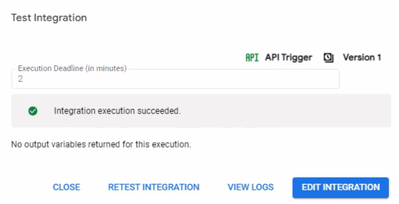

I am trying to copy data from one mySql table to another mySql table, but while fetching data only 25 rows are pass to another flow(to load data to another table) instead of full data.
Below are my configurations,
Flow1: to fetch data from 1st table
np1_3-1704279615595.pngnp1_4-1704279745309.pngnp1_5-1704279777302.pngnp1_6-1704279792712.png
flow2 : to load data to 2nd table
After testing flow1 it is in succeeded state always but only 25 rows are inserted.  Can anyone suggest here how to fetch full data.

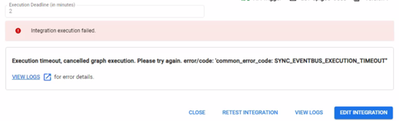

Hi @Meenchou ,
I have tried this pagination flow but i am getting below error,

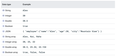

I manage to get a token back when the only value I add is listEntitiesPageSize but I continue to get the same error as @np1 whenever I try to set the listEntitiesSortByColumns value to anything or if I try to set the value of  listEntitiesPageToken to the listEntitiesNextPageToken.
Do you know if there is a specfiic format that should be used for the sort or page token columns? I noticed that listEntitiesSortByColumns should be a string array and i am entering it in the same format as below but continue to receive an error:
Maybe it could be down to that?
Hi @mfers
On the listEntitiesSortByColumns  then what I did was to create a variable of type 'String Array' and then include the database column name as the Default Value as shown here:
(col_int is the name of my database column, note it doesnt allow you to have multiple sort columns)

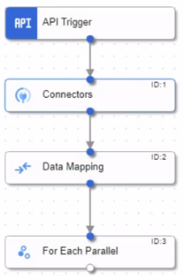

On the question of the next page token mapping then it should be a case of mapping the 'NextPageToken' from your first call to the 'PageToken' of the next. For my dummy integration I had 2 connector calls, one to get the first 25 and another to get the next 25 as shown here.
The mapping stage prior to the 'next 25' call had:
This simple test worked fine for me to prove the concept. If I wanted to build something production like then I suspect I would need to have something that say reads the first 500 rows, and if the results are non-blank it would call the same integration to process the next 500 via an API Trigger call passing the next-page token across.
