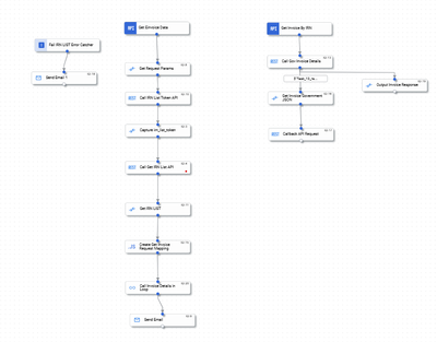

I am creating one integration flow in which I make the call to the api.
I am using API Trigger

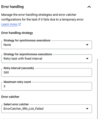

The flow includes calling the api if the response is 400 then it have to retry.
Its working when i use the Test to call the Trigger after increasing the execution deadline more than 10 min. But not working using the curl request .
Can anyone give me idea to implement the async call via API trigger or any other option.
Here I am adding the workflow.

for async call but it fails and give error for the api on 1st retry (retry on hold).
it should try for the retry 3 times as i given in error handling
0 2 245
If you want to call the API Trigger Asynchronously, then you can use this API instead of the execute API.
https://cloud.google.com/application-integration/docs/reference/rest/v2/projects.locations.integrati...
