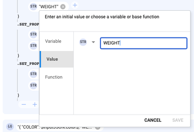

For the weight mapping, I also used the GET_PROPERTY to show that you can also use this syntax in case the dot notation reference is not available to you.  So, in this case, you are using the SET_PROPERTY, and the first argument is the value you want to put in the output, and then we use a string value input for the second argument, which is the property name.  I just typed in WEIGHT into the Value option on the input as a String type.

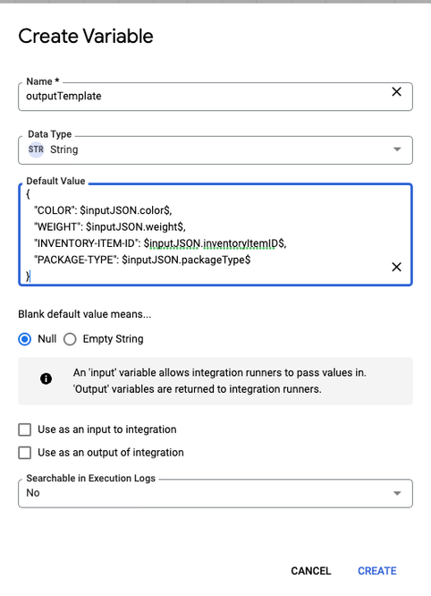

First, I create a local variable of type String with the Template value that I want to use to create my output:
