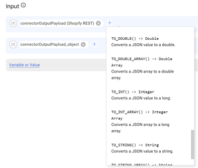

@ianala
Can you try this
ConnectorOutputPayload (Shopify Rest). TO_JSON() -> ConnectorOutputPayload_object
@Meenchou
To_JSON() is not displayed in the list of possible functions to apply to ConnectorOutputPayload (Shopify Rest).
Kindly send  private message to me with details of project name and integration name. We will look into it and revert back

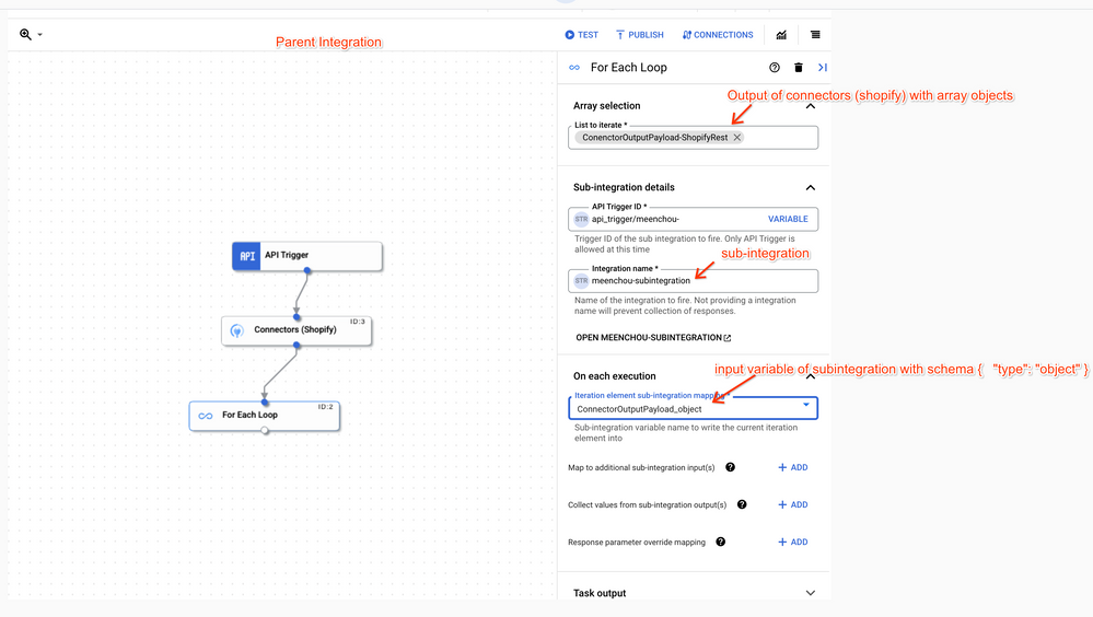

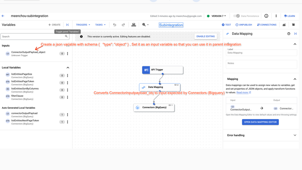

@Meenchou helped to create the sub-integration and connect it to the main integration. That solved an issue.
It seems like bigQuery connector input payload is expecting a single object and not an array
you can use foreach loop task to loop through that array and call the subintegration which would eventually call big query connector and the output from the task can be collected in your parent integration parent_intg.pngsubintg.png
Note:Publish the subintegration first and then refresh your parent integration
If you want to test the flow, you should directly invoke the parent integration and the value will be automatically set from parent integration
If you just want to invoke your subintegration for testing purpose, then you need to provide the input value

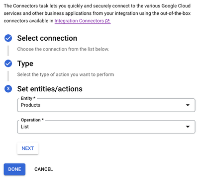

Shouldnt we use Create operation for Bigquery connector here instead of List  since we want to store the data in Bigquery. Whats the point of keeping it as list operation here? I'm confused
You are correct, the LIST operation is like a SELECT * FROM Table Where Filter ; operation, so it will return a list of results.  You would want to use the Create operation to insert a row into BigQuery (in a loop for many rows)...

Here are the Shopify connection task configurations:
Screenshot 2024-04-02 at 2.02.24 PM.pngScreenshot 2024-04-02 at 2.02.56 PM.png

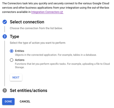

And here is the BigQuery Connection configuration (Task ID:15) ... I used the "Entity" option, and selected my dataset "shopify.products" and the "Create" operation

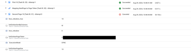

@shaaland Hey! I'm following a similar method to the one you shared above. However, I have a lot of records to pull from Shopify so I would like to use the method of a while loop and page tokens to go pull the data from each page, insert into bigquery and repeat.
Currently, I have found the issue that whenever I assign the value from ListEntitiesNextPageToken to ListEntitiesPageToken, I get an error.
Similarly, whenever I try to add a default value for listEntitiesSortByColumns I also get an error. Do you know why this could be? I am adding the data in as a string
Send me a DM and we can try to troubleshoot it.
Thanks so much for your reply- I don't seem to have the DM option yet on Google Cloud as I joined not long ago.
I think the issue is when assigning the listEntititesNextPageToken to the ListEntitiesPageToken for Shopify it looks like it's not able to process the token. I keep getting the error 400.
For example, even when simplifying to an integration as below:
the first task of returning 10 runs fine, so does the data mapping but after assigning the nextpagetoken to the page token there seems to be some kind of processing error:
Logs:
The other variables are part of another integration* and it doesn't matter the length of time I assign to test this- the error code comes back nonetheless
