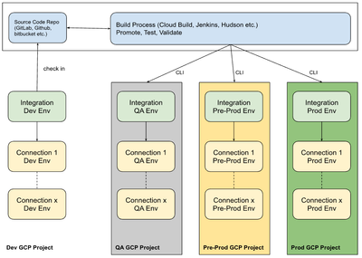

Principles
There are a few (opinionated) principles followed in this example:
  1. An integration flow developed in the development environment must be deployed unchanged in production. Treat the integration flow like one would source code.
  2. The portions of an integration flow that do change from one environment to another are externalized. Only those properties change between environments. For example, the HTTP URL configured for a REST Task.
  3. There must be traceability between what is stored in a source code repository and an integration flow version deployed in an environment.
  4. Maintain a single repository for each deployable service
  5. Automate the deployment between environments
  6. Test in a clone of the production environment

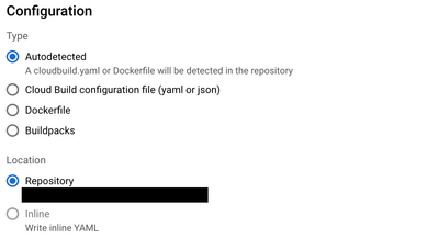

Automate deployments with triggers
Setup a Cloud Build Trigger as shown in the screenshot below
This will trigger deployments to the qa environment automatically as soon as changes are merged with the qa branch.
