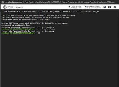

Upon trying the cd command via ssh I get the following error:

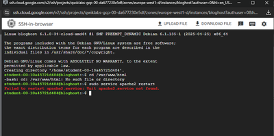

Whilst of course I can create the text file in nano and call it index.php, it's not accessible - the restart apache server command is useless given that the apache service isn't running:
So when you try to connect to the external IP address of the VM instance, well, it doesn't want to speak (no apache server running).
