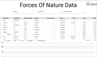

I have this table that shows the data from a dataset in google sheets. Now, what i want to do is make an extra column on this table, that basically does this:
If the helps of the user are above the average of all the user's help, the field shows "1", otherwise, it shows 0. I have tried to do this myself but i can just not get it to work. Any help is appreciated. Thanks!

@HerculesVent I AM not sure its doable without a custom query form a database. Something similar you can achievie by creating a Field with average and then using a conditional formating and instead showing 1 or 0 just change a color based on the result.
Yea what i am trying to do is make a field with the average of the whole column. Thats what i cant figure out how to make. If i just select average here:
It just doesnt work, since only 1 entry is for that row. I want a field to have the average of the whole column.
As a general rule of thumb always seek to do transformation and aggregation steps in your original data source. According to my knowledge there is no way to achieve this in LS directly. While its reporting capabalities are decent the data transformation options here are really limited.  LS was designed to focus on the front-end mostly. Thhe formulas here are bit limited but folr anyone using BigQuery as a data source it is never a problem.
