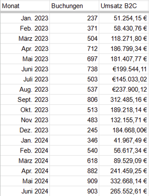

I've got a GSheets Table tracking Orders and Revenue per Month like this:
The first column is a Date Column formatted as MMM YYYY).
When I pull the data into Looker Studio, I can set the timeframe of the report - e.g. for 2024-01-01 till 2024-06-30 - and Looker Studio correctly only shows the 2024 values in the table.
When I then try compare the data to the previous year (comparison timeframe), it does not find the delta and reports them as "-".
The table is set to:
  • Timeframe dimension: first column of the table
  • Data Dimension (granularity): YYYY MM
  • compare to: previous year
How come it's not pulling the data from previous year's month correctly?

Could you post the settings of the actual settings of the report? It would help me give you a more exact answer.
I would double check that you are constricting the time frame of the actual table and setting the comparison time frame correctly, the data looks fine. (Although because of how google sheets works if you have multiple types of dates in there it may error out. It looks the same in the picture but it could just be that you have a data format on it that makes it look the same but the underlying data may be different.)

Alright, this is the actual table. I've set the focus to A2 to show what the field actually contains (although the formatting is set to MMM YYYY):

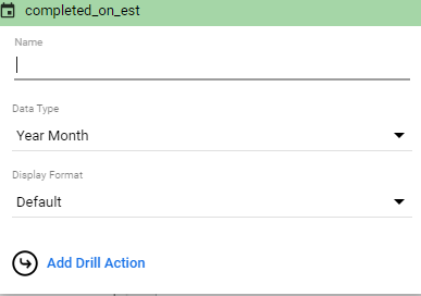

For "Datum", I would parse that to be a normal date, IE the original date of 01-01-2024, 02-01-2024, etc. This will ensure it works fundamentally with the date picker. I would then click the little calendar button on the dimension "Datum" and change the data type to the year month data type.
This should ensure that it works with the Comparison date range.
Here's a link to more date information.
Note: I would ensure that the "Date Range Dimension" is left as the "Date" data type, when you change it to Year Month it can get a lil' funky.
