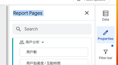

Click Properties, but showed Report Pages
I found a bug that was when I click Properties menu, looker studio showed "Report Pages".
Now, I couldn't change the Properties

I'm having this same problem. It's only on one report, but it's on every chart in the report.
Note that trying to close out the Report Pages window or modal does nothing
The same is happening for me, as well. Is there any reported fix?
