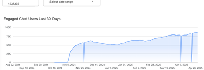

Exactly the same issue here with input box. I'm using the new 'responsive layout' and there's no way to change order.

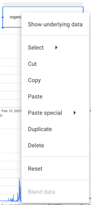

Same issue here. @patryg17 are you also using the new responsive layout?
@Beginner changing the order of the control is not possible in the new responsive layout.
