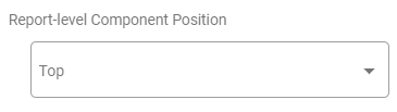

So just to clarify, if you go to Theme and Layout, click the Layout tab, and scroll all the way at the bottom, the 'Report-level Component Position' is set to Top? If it is set to Bottom you will never see report-level elements in the front.
