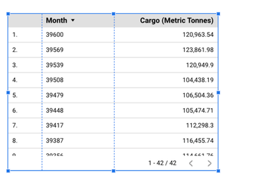

And here is the month field in a chart
It is a number field

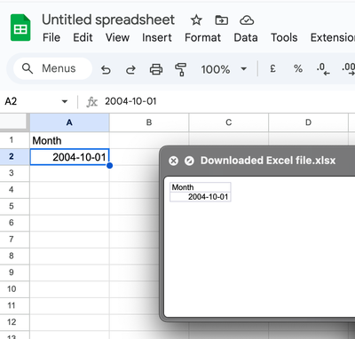

Could you also share this column in the excel file you download from google sheets?
When download a sheet containing a date that is formatted like yours as an Excel file, there is no change in formatting:

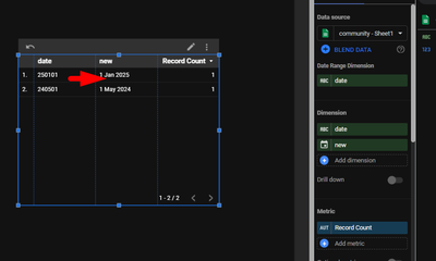

Hello, you need to change the date format to 'Text' first in Looker Studio. Please check the screenshot below for reference.
Then, enter the format PARSE_DATE("%y%m%d", date) in Looker Studio, and it will be done!

Hi, in my Looker Studio, the custom field is in 'date' format. Therefore, you need to change the field format to 'date'. Please check the screenshot for reference

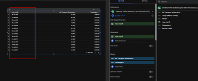

I used this formula to create a new column in your Excel sheet, imported it to your LS, and it worked. Please check the screenshot below.

Yes, when you create a new column in an Excel file, just import it directly into Looker Studio. Also, remember to check if the new column (new month) is set to the "date" type. I checked your screenshot, and yours is set to "string," which I believe is one of the main reasons for the issue.
Here are my steps:
  1. Add a new column in the Excel file using the formula: =A2 + DATE(1900,1,1) - 2
  2. Import the file into Looker Studio
  3. Verify that the column is correctly set to the "date" type
  4. Create your report, and you're done!
