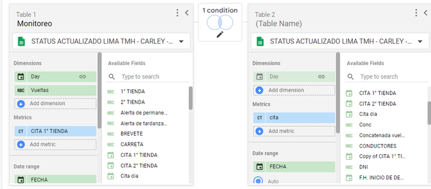

I can't group blend data by year or month in Looker Studio. When I tried to change day (original data type) to year, data remains at the date level, and the year gets repeated on every single line. Same will apply to line charts, bar charts.

Hi Sam, hope you're doing well. I tried this in a blended table, but it didn't work well. I have two tables that I visualize using the date as the main dimension and when I want I can group the info by week, month, etc. But when I blend both tables and try to do this the info is grouped by day. Even if I try to change the format it only change the visual format but never groups the info. I tried with COALESCE and using another table with the dates like you explained. But nothings seems to work well.
