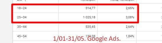

Why does the data on conversions that Locker imports from Google Ads differ from the data of the Google Ads account itself???🤔🤔🤔 Some absurdity🙄
Here is the difference in statistics by age (screens). The dates are the same, there are no filters!конверс looker.jpgg ads.jpg

1) since the end of the reporting period that we are looking at, five days have already passed, and the update period in Locker Studio is 12 hours. This is the first. And secondly, of course, we updated the report using the "Update data" button
2) regarding data sampling in Google Ads... Please tell me where you got this information from? I have been doing Google Ads for over 15 years and this is the first time I have heard about data sampling... As far as I know, Google Ads displays absolutely 100% of all advertising data!
3) regarding the time zone... It doesn't seem like a difference of a few hours would cause that much of a difference in the data. But please tell me where in Locker Studio is the time zone setting? I don't know of such settings, and today I looked through the whole Locker Studio again and did not find such settings. Please tell me where they are? I'm interested to see
4) do you mean that if you use another third-party import connector instead of the official import, then the situation will change and the accuracy will be 100%? Have you had this experience?
thank you!!

in this case, which we are considering, Google Analytics does not appear at all! The import is from Google Ads to Locker Studio, so there's no sampling there...
Regarding the time zone in Locker Studio - sorry, I didn't understand what you meant.
