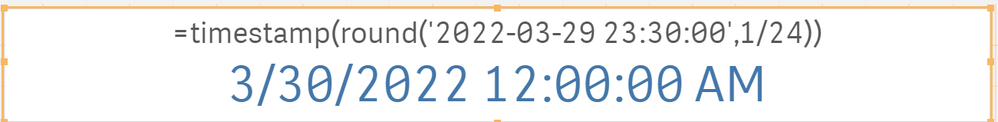

I want to round my field to 1/24, or I can say hour as:
=timestamp(round('2022-03-29 23:30:00',1/24)) is equal to
This will always round the timestamp at hour level and join always work for both tables.
I am struglling how to do it in Looker+BQ.
I know how to do it other tool like Qlik but I am new here, need your help.
Can you please tell me how to round the timestamp by 1/24. 1/24 is the step. When I say step, it means, read below example:
