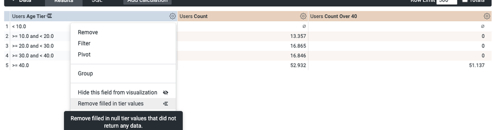

Hello liamsebestyen,
Working with these nulls is tricky.  Let me explain what I believe you are running into.
Generally speaking, Looker DOES tend to show null/missing measure values as 0s.  For example, the standard sql of type:sum measures includes a coalesce function to present the sum as 0.
However, in scenarios where there are literally no records in the underlying dataset (but there is nevertheless space for them on the table), a null value is presented.  Furthermore, since there's literally no data, it's not possible to update the presentation (e.g. in HTML parameter).
Here's an example to hopefully clarify: This dimension is a case based dimension and so when i let the default dimension_fill feature be used on the dimension, I get a placeholder row for <10 (for which there is no underlying records at all).  On the right measure, notice there are 0s where there IS data (records in that dimension), but none of those records actually qualify to be counted in the measure... Again, this example is to highlight that looker is present null sign when there are literally no records in the underlying data
These null value cells commonly occurs in two different scenarios:
  • when using dimension fill as shown above
  • or when using pivots (where some cells represent a combination of dimensions for which there are no records
Unfortunately there is no known practical approach to change how these filled-in cells (i'll call them) are displayed in Looker, though removing filled-in values option may reduce the visibility of these on your dashboards.
I hope this helps you understand the nature of this issue and helps you work around it.  Best of luck.
Hello Kevin, thank you for your in depth response. You mention that sum: returns zero using COALESCE as built into Looker. I believe in this case the type: avg measure returns null when there is no data (0/0) division, and doesn't change this to zero. I have done some work arounds by doing the avg manually by doing COALESCE(AVG(${age},0) but I found it didn't work with the filters it needs. Let me know your thoughts.

Glad you found that approach for average.  If it works in some cases but not on other places (e.g. depending on filter as you mentioned), I'm guessing this is still a case like I described above where we have cells where there's actually no data at all and looker is 'filling' the missing cells (for fill_fields or pivot intersections).  Can you check if that is the case, as that is a special type of challenge that can't really be addressed in Lookml.
Hello Kevin. I managed to make it work using a table calculation. I appreciate all the help, in addition to providing more information on how looker works. I appreciate the effort you have put in to help me.
