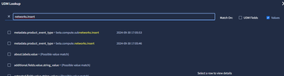

Yes those are included.  When trying to improve queries to narrow down your results the trick is usually finding the right UDM fields to filter.  If you don't already have a lot of experience with UDM the best way to find which fields include that info is using the 'udm lookup' function at the bottom of the search box and to search for the distinct value.  This will search against all the fields in your SecOps tenant and help you find where your data is being parsed.
In this example I can see that compute.networks.insert is being parsed into the metadata.product_event_type field.  So we can extend UDM search from the earlier response with a regex for your method names against that field, and you should see just those events.
metadata.log_type = "GCP_CLOUDAUDIT" AND metadata.product_name = "Google Compute Engine" and metadata.product_event_type=/compute\.networks\.(insert|patch|delete)/
