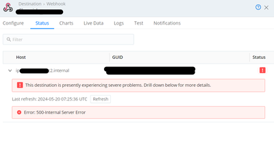

The same url format I tried to configure a cribl webhoon destination. Please find the below snip.
Could anyone please let me know what am I doing wrong here?

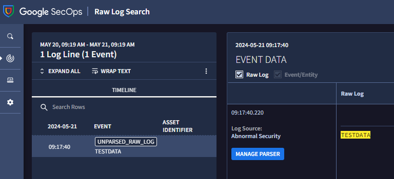

EXAMPLE CURL
#curl "https://eu-chronicle.googleapis.com/v1alpha/projects/123456789/locations/eu/instances/123456-1234-12..." -d "TESTDATA"
Data pushed via webhookData pushed via webhook

Please find the below snip. It is again throwing 404 error.
