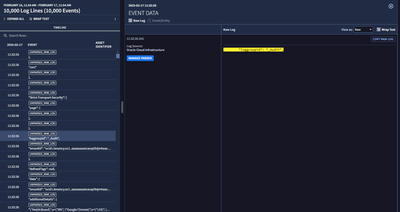

I recently integrated Oracle Cloud Audit logs via an S3 bucket. The logs are in JSON format, and while SecOps is successfully pulling them, Iโ€™m encountering an issue with the log format. The logs are breaking incorrectlyโ€”either after each line, comma, or curly brace {}โ€”resulting in improper ingestion.

I have tested both log labels for the Oracle Cloud audit logs, but the logs are not being parsed.
The primary issue seems to be with ingestion from S3 to SecOpsโ€”the logs are being ingested line by line. Could you confirm if thereโ€™s an issue or suggest an alternative method for ingesting Oracle logs into SecOps?
