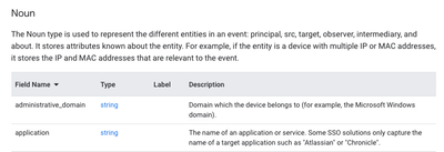

It speaks to the Nouns in UDM:
However the doc page doesn't make any reference to the above. If at all, it does have a section as follows:
But the content seems to be a bit disjointed, or perhaps, i am not able to connect the dots.
Can someone please help me understand how is it that i should go about reading this page.

Regarding nouns, the link you cited is the breakdown of the basic roots of udm, where the nouns reside. In addition to those nouns, metadata, security result and extensions reside at this basic level. The idea behind a noun is to describe that portion of the event log in relation to another. Other schema might refer to something as a source or destination for example. Our primary noun is a principal, that is generally the initiation of an action comes from this noun. Target is the next most often seen where something is occurring or being performed against it.
To navigate through the field list, we are going to explore to understand the tree structure. If I have a field called principal.application, that's pretty straightforward. Principal is the noun and as the field name is application with a type of string, the description is what would be in that field and we are done.
With a field like principal.process.file.sha256, the navigation of the field list can get a little trickier. Because all of this is json, the field list is pretty extensive and because the same fields are used in all the nouns, it made sense to lay it out this way, but it does take a little time to get used to it.
To work my way to the sha256, I can scroll down to process under noun and in the type, rather than string or int32 or whatever, we see Process. Clicking on process takes us down to the Process portion of the UDM json tree. (principal.process.)

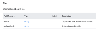

Within the process tree, we have a set of fields but also additional branches for file and parent_process. Clicking on File next to file will show us the fields that are available within that section of the UDM schema. (principal.process.file.)
And within the file portion of the json tree, we have additional fields including sha256. Notice it is listed as string and a description so that is the end field we are working with. (principal.process.file.sha256)
