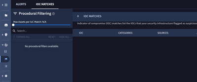

I have been ssh'ing to the ip / hostname that is in my test csv and there is no alert being thrown in IOC Matches -> Detections -> IOC Matches.
Furthermore, when you filter the IOC Matches sources, there isn't one for the custom csv.
