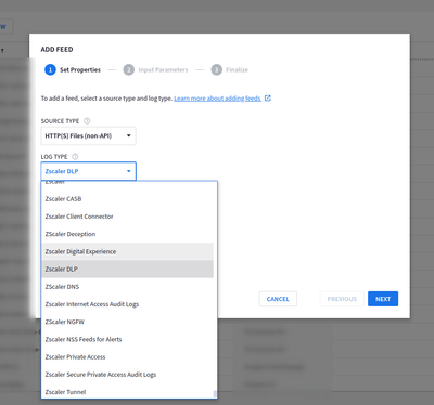

Thank you! The guide mostly worked, but it turnes out Cloud NSS is a separate entitlement/license that not every customer has. @adam9 perhaps the docs could be updated to indicate that! A screenshot might also help, since if the license is not applied that tab is just not visible and when you start setting up a regular NSS feed the settings are not the same.
