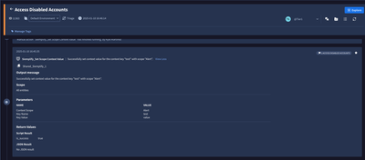

Thank you for your question.  You can see the context value in the case wall under the action that set the context value.  Here is an example where I assigned a key named 'test' a value named 'value':
Please let me know if you have additional questions!
