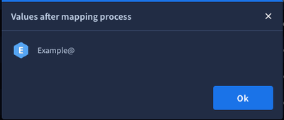

@vanitharaj1208 both regex patterns works for me:
1. with @
Result during ingestion (before regex):
2. without @
To view values after mapping process I clicked on "Show results" under 3-dot menu:
I think it is working, to validate the result you need to click 3-dot icon as shown on a screenshot:
When you howerover your mouse above "green" mapped value, it shows only original value, but not end result of mapping.
1. with @
2. without @
Agreed, I tested here as well and the look ahead works, but note that if the user has a " . " in the name like Joe.smith@acme.com, then you will only get "smith" if your regex is "  \w+?(?=@)  ", you may be better off using the wild card in the regex like "  \w+.*(?=@) ".
When I checked the result in the vertical dot menu, my result was as expected
