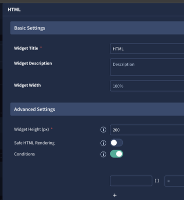

A predefined widget is specifically one that comes with the marketplace integration pack.  To make your own we just use the HTML widget it's the same technology.
Tip - If you like the OOTB widget style, use one and look at the HTML code, then copy paste it out and modify the data structure.
Note - 'predefined' widgets also have 'Condition' applied so the widget hides if the Action hasn't executed.
There's also a community article that goes into some detail about this. Everything you need to know about Predefined Widgets
