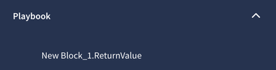

I have a playbook, I dragged in a Block that has 4 outputs
In the playbook, when I reference the output, I only have 1 output

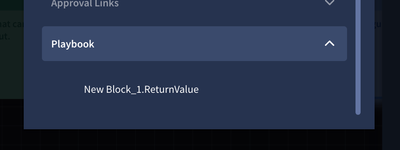

The first image shown here is from the block showing the 3 paths that can be taken at the end once my queries have run. The context is that I'm running a tanium query for md5, sha1, and sha256 hashes. Only one of these queries will succeed, and the json result of the other 2 should be null/blank. At the end I check which one is not empty and return that as the output for that path.
The second image is my insert placeholder tab in a parent playbook for an action that comes right after the block from the first image, and as you can see it's still allowing me to select any of the 3 options as input. I would need to do the same check I did in my block in the parent playbook which would be redundant. I'm wondering if there's a way within the block to assign the json output I deem not empty as the sole output for the block. This way, the playbook always just grabs this one output and never has to check all 3.
In your second image, those 3 refer to the specific Actions in the playbook, all of which are accessible by design.
If you want the output (regardless of the path it took to get there) look for the Block ReturnValue

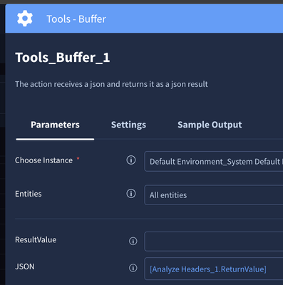

For exp: If this ReturnValue is outputs a dictionary, how to access certain values there ? how to parse this output and use it in next action blaocks ?
Correct, Block return output (and also the value of "get Context") will return in a string form.
Use the Action 'Buffer' to convert the Block ReturnValue back to a JSON object, then access [Buffer.JsonResult | "key"] as normal  etc
