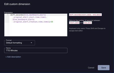

You wont be able to access event fields from the Advanced Reports. However, you should be able to achieve MTTD metrics suing the Alert timestamps. You will have an Alert Start Time - This will be the time of the first event in the alert - and the Alert creation time - when the alert was created in SOAR.
You can create a custom Dimension in your advanced report calculating the difference:

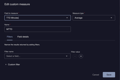

And then use that to create a custom Aggregated Measure to display the MTTD:
(Screenshots are from a Demo instance so that's why the number is so high - not realistic)
