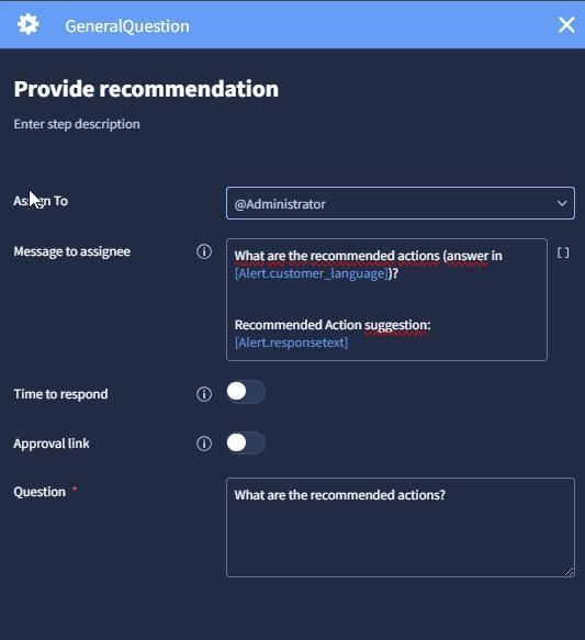

Hello all,
I have the issue, that I want to put into the field "Message to assignee" a string which is larger than 250 characters (including the content of the placeholder variables).
The field is limited to 250 characters and I am unable to execute the question in a case if the the field contains more than 250 characters.
Had anybody the same issue and can help me?
Thank you,
Marinus

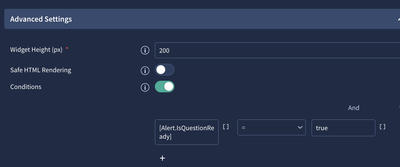

1 possible workaround
Design a HTML widget that references the 2 large placeholders
Before your question set an Alert context variable "Alert.IsQuestionReady" = true
After your question set an Alert context variable "Alert.IsQuestionReady" = false
In your HTML conditional logic have [Alert.IsQuestionReady]=true  (see image)
Update the Question body to say "Check Big widget for suggestion"
Thank you Andy I will try that!
