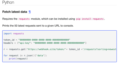

Going back to the slack integration, I think i've managed to understand the part that was confusing me. The slack integration is tightly coupled with webhook.site. It will only ever work with webhook.site. One can change the URL, but that won't change the functionality. Heres an example that didn't make sense to me until I lowered my expectations:
The webhook.site api docs contain a very similar snippet:
If we want this to work without webhook.site, we need to either create a webserver that functions in the exact same way as webhook.site OR update the native slack integration's python code.

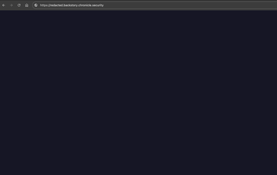

Hey Andy
Thought i'd give it a try. When I test with another user, I get a blank screen:
If I then refresh the page I get prompted to auth with google and when doing so get the following error:
If we want to use approval links, is it recommended that we give basic view rights on the GCP project to the entire org?
Apologies I never saw this
The approval link should be in the format
https://<redacted> 443/#/approval-link?token=NaU52dGgVAB3Ijwf%2frxmkA%3d%3d.i%2ft9EGUwDl1%2fRaNcUMvD3f5yeI3e3WuIQSzZ8e%2bDLdfZGhp9CEaHORLgOLmiMpfsBQzPX%2bi3XoSkBuXs0yUUyibTXIrZz0OCdnhxvCsxC14%3d&hash=b7f06db7b4a12299f76eaa6d29d24ecdd3ae2e8a094500bcb3e95d0c0e69bc95
As above, approval links require 0 access to GCP/SecOps and can be sent to any user
