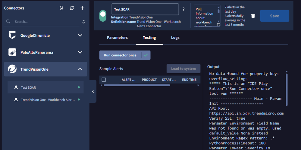

Hey Ankur_8991, based on the screenshot that you've shared, your configuration for connector is valid, because you've already managed to ingest 2 alerts in the last day.
Maybe, you've missed those alerts, because they were grouped under a specific case, but to confirm that the configuration is correct, you need to go to "Testing" tab and see, if you get a green checkmark (it's okay, if no alert is shown after test run, because there might not be any during the provided timeframe).
Hi @ylandovskyy
Yes, the testing tab seems to be working correctly:
Full output:
No data found for property key: overflow_settings
***** This is an "IDE Play Button"\"Run Connector once" test run ******
------------------- Main - Param Init -------------------
API Root: https://api.in.xdr.trendmicro.com
Verify SSL: true
Paramter Environment Field Name was not found or was empty, used default_value None instead
Environment Regex Pattern: .*
PythonProcessTimeout: 180
Paramter Lowest Severity To Fetch was not found or was empty, used default_value None instead
Max Hours Backwards: 1
Max Alerts To Fetch: 10
Use dynamic list as a blocklist: false
------------------- Main - Started -------------------
No data found for property key: ids
Key: "ids" does not exist in the database. Returning default value instead: []
Successfully loaded 0 existing alerts.
No data found for property key: timestamp
Last success time. Date time:2025-03-03 15:16:33.763907+00:00. Unix:1741014993763
Fetched 0 alerts
This is a TEST run. Only 1 alert will be processed.
Alerts processed: 0 out of 0
Created total of 0 cases
------------------- Main - Finished -------------------
Dynamic script connector completed successfully but returned no cases..

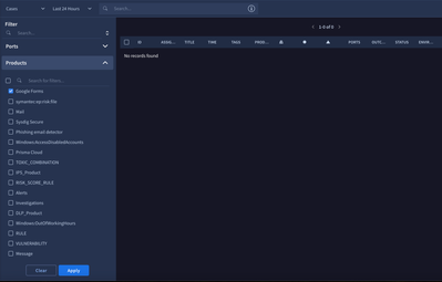

My suggestion would be to go to Search -> SOAR Search. Inside of it, set a filter for Cases that contain an alert with Trend Vision One Product.
I don't have your connector installed, but here is an image for reference. In my screenshot I am searching for Cases that contain a Google Forms alert in the last 24 hours.

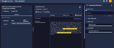

I am receiving the alerts via log forwarding and the logs looks like we are not receiving all the needed fields/ logs. Hence, I was trying with API SOAR connector and for this workbench ID I dont see any logs. More details below
Raw Logs:
<130>Mar 03 2025 16:29:01 tpi-external-in.xdr.trendmicro.com CEF:0|Trend Micro|Trend Vision One|1.0.0|900001|Trend Vision One Workbench Alert|9|rt=Mar 03 2025 16:27:05 cat=Registry Change cn1=2 cs1=https://portal.in.xdr.trendmicro.com/index.html#/workbench/alerts/WB-11452-20250303-00014?ref\=f4c674ed41a4a1f06600c86a4c2fe2f5b0ac56ee msg= cn1Label=Impact Scope Count cs1Label=Workbench Link externalId=WB-11452-20250303-00014 sourceServiceName=SAE
Search result:
Not sure where the logs are going to??
It's important to understand that SOAR ingestion and SIEM ingestion are not 1 to 1.
If you've used SOAR connector to ingest data from Trend Vision One then this data is not going to create logs in SIEM, because you directly ingested Trend Vision One alerts into SOAR Alerts.
To have logs in SIEM, you need to setup the feed and parser.
