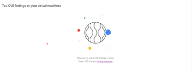

I am facing issue with Security Command Center(RiskOverview) page and given detailed steps as below.
  1. I have permissions for Security Command Center(SCC) with "Enterprise" at Organization level and  "Premium" at Project level.
  2. But I could not be able to see any information in "RiskOver" page for  "Top CVE findings on your virtual machines".
  3. I have gone through various SCC documentations and changed IAM permissions for my account to see the information for  "Top CVE findings on your virtual machines".
  4. After trying a lot of ways, I came to here for a solution. Please suggest how to proceed further and if any other information is required from myside, please let me know. I will provide the required information.

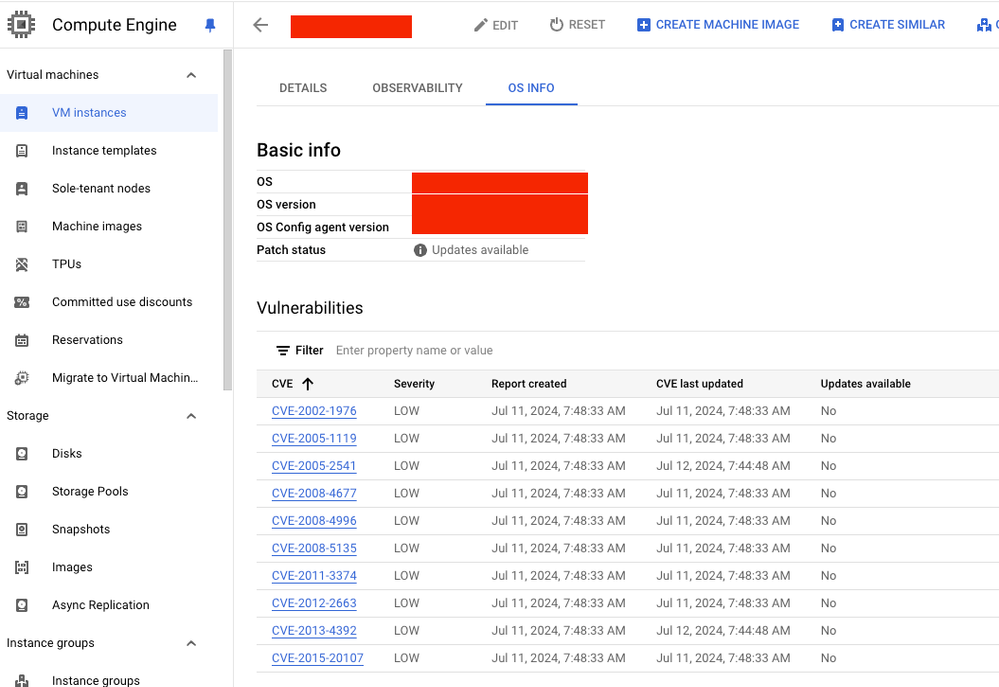

I have previously followed it and also enabled VM manager API in my current project as well but that solution did not work for me.. I was able to see all components in Risk Overview page(SCC) except the "Top CVE findings on your virtual machines". For better understanding, I am attaching a screenshot.
For your information, I have installed xz-utils vulnerability and also see CVE under compute engine( under OS_Info). But the same(CVEs) are not reflecting in Findings page as well as "Top CVE findings on your virtual machines".

Can you see the Vulnerabilities for the instance under the VM instance details?

I would normally only expect to see Findings in SCC if the VM Manager part is enabled and running properly. If you don't see anything in the VM Manager part i would recommend trying to concentrate on that part first and verify if all the requirements (including the OS Agent) are present and met. I would recommend checking out this link for all the pre-reqs and steps and see if anything missing
