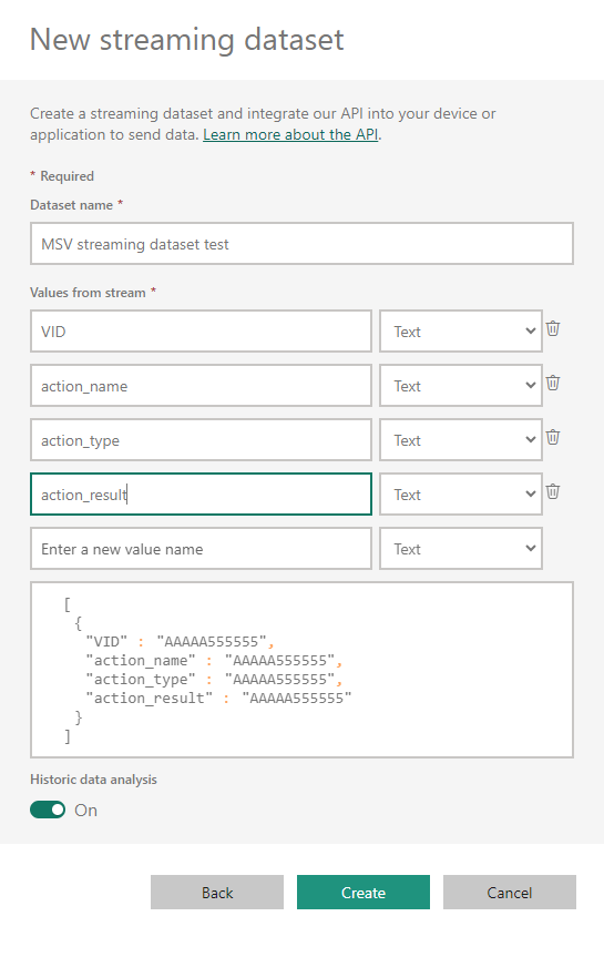

However, during the creation process it is necessary to specify what data will be sent to Power BI through the REST API.
For example:
I expect that MSV pipelines have already defined what fields will be sent to Power BI, so I think it is necessary to know these fields and their type to configure the integration.
Do you agree?
Would you be able to tell me a way to retrieve this information?
Thank you,
Paolo

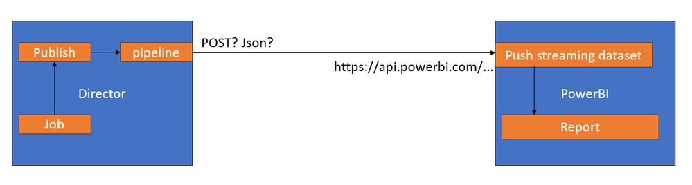

However, before proceeding, I would like to share with you this simple scheme, to confirm if I have understood well the operation of the pipelines and their integration with PowerBI.
What I have deduced is that MSV with pipelines can invoke a PowerBI API to "pass" job data. It seems to me that it can pass them in JSON format, but I have not been able to confirm this hypothesis.
Can you confirm that pipelines work in this way? Or is the mode with two Directors and the MSR license the only possible one?

Yes you are correct in that that the POST from the Director to the webhook contains data in JSON format. The only difference between using Webhook and using the MSR pipeline, is that while both do a POST containing a JSON, the Webhook allows the BI tool to normalize the data, while in MSR, the Central Director will parse the data into tables prior to shipping it over to the BI tool.
For the second question, unfortunately, there is not currently a way to do this, but we have received this request from other customers and entered it as an RFE (Request For Enhancement). I can update this thread once that RFE has been complete and the feature is available.
There are no dedicated log files within the Director to include details of pipeline attempts. You can view your publish history and the results by navigating to Jobs > Pipelines, clicking the kabob Menu, and clicking 'View Publish History'.
I have attached an exported json from a lab instance as an example of the JSON data that is shipped via pipeline in hopes that the fields are useful to you.
I appreciate your questions and feedback as we further adapt this process!
