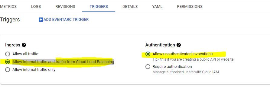

Hi Team,
Thanks for your response on this.  The cloud is set to Authentication as "Allow unauthenticated invocations" . Please the attachment.
If I set the ingress as "Allow all traffic", I am able to access using cloud run url and from DNS thru load balancer.
If I set the ingress as "Allow internal traffic and traffic from Cloud Load Balancing", I am unable to access cloud thru url and with load balancer. (but able to hit the cloud url if I access from VM which is on VPC in the same project where cloud run deployed).
So what I am not clear is with the "Allow internal traffic and traffic from Cloud Load Balancing" ingress setting. what is mean by a Cloud Load Balancing ?
my assumption is, if we have set-up a HTTPS load balancer (HTTP(S) (classic)) with NEG backend for above cloud run, it should work as the request comes form Load Balancer (with the definition of above ingress setting).
But its not working like this, I have tried from a Load balancer set-up in same project where cloud run deployed as well a load balancer sits in another GCP project.
Please let me know If I am missing something on this setting.

hi @abdelfettah , its working now. you are right, the cloud run and LB to be the same project, and the Network end point group type should be Serverless NEG. Initially I created it as Internet NEG and used FQDN.
thanks for the information.
