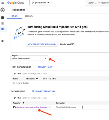

Hello @durraniu  ,Welcome on Google Cloud Community.
Did you've checked Triggers or Repositories in Cloud Build service? From there you should be able to check and connect repositories. Make sure that you are choosing correct region ( global in my case, as I've connected my GH repo).

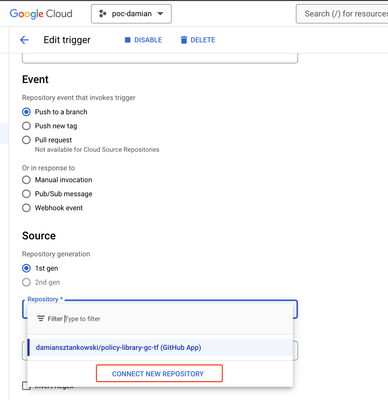

PS; You are able to connect new repo during triggers editing:
