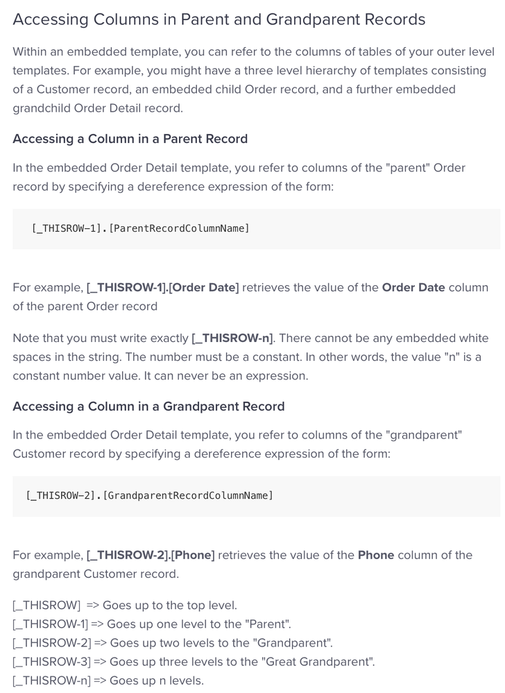

This part, in this article: Template Start Expressions | AppSheet Help Center. I could only make my template work through trial and error, and at the end I couldn't reconcile what I did with the doc so that together they make sense.
Yeah, it took me a log time and some experimentation to understand that mess. It really all comes down to this:
https://www.googlecloudcommunity.com/gc/Tips-Tricks/FAQ-FILTER-LOOKUP-MAXROW-MINROW-REF-ROWS-and-SEL...
Wow! Thanks @Steve this is awesome! Unfortunately I didn't notice this part before in the comments. I guess the concept that [_ThisRow] being a shortcut to the topmost level from any lower level was what evaded me. Very informative graph and excellent explanation as always. If it was up to me, I'd just ditch the whole AppSheet documentation and replace them with your community posts, unless you were the author. Seriously :).
I'll study your whole post again in detail.
One question please, so in a template we can treat a <<start:>>/<<end>> as a level as if it were a SELECT() statement, with this my now-working-after-experimentation expressions in the template would finally make sense. Is my conclusion correct please? Thank you!
Yes. The template itself is _THISROW. <<Start>>/<<End>> is equivalent to a query.
