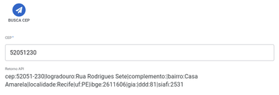

To make a GET API call while filling out a Form, you can use the Google Sheet IMPORTDATA(url) function, which must be resident in the worksheet. Below is an example that uses the public API to fetch the string with address fields from the zip code entered in another cell:
In the Form, you can use a Detail type form with โ€œQuick editโ€ and create an Action of type โ€œApp: Go to another view within this appโ€ to force data synchronization: LINKTOVIEW("view name")& "&at="&(NOW()+1)
PS: "Busca CEP" is "Search ZipCode" in Portuguese.
Thus, after fill the field that will be used by API GET call, you can just hit the Action to get data updated:
