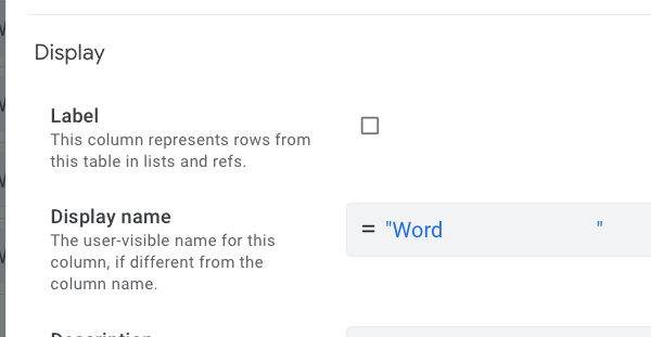

If you use “Save and verify” instead of the normal “Save” after editing a table, the platform should adjust the width of your columns appropriately. But, sometimes the platform may not do what you want it to. For example, in the following example “Word” is a virtual column and, for whatever reason, “Save and verify” did not expand the width to accommodate the text in the column on the third row:
My solution was to add Japanese spaces to the title:

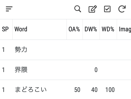

This produced the following:
You don’t need to be able to read Japanese to see that the text on the third row is now displayed comfortably.
I tried doing the same with ordinary spaces but to no avail.
This forum seems to be set up to convert Japanese spaces to English ones so I can’t share an example space here but you can find the unicode for Japanese spaces and text to copy here:
This is a temporary workaround, I fear. I hope AppSheet will give us more ways to control spacing in tables.

Awesome! So simple! It’s like why didn’t I think of this before. This is a good workaround to help with column spacing. I find even with the “Wide” setting for column widths in tables, that columns do not reflect expected widths.
I’m glad this is useful to you. Perhaps you’ve dealt with the Japanese language before, but if not, I wouldn’t expect you to think of it. They are both “spaces” but the difference in character codes can lead to different behaviors.

HI @Kirk_Masden I think you can use all other whitespace characters as well. I was doing that in this example:
Please also scroll down to my post from May 11.
Thanks @Fabian ! I think I tested it with ordinary spaces and didn’t have any luck. I’m not sure why. But, it looks like AppSheet will give us more control anyway so it may be a moot point.
