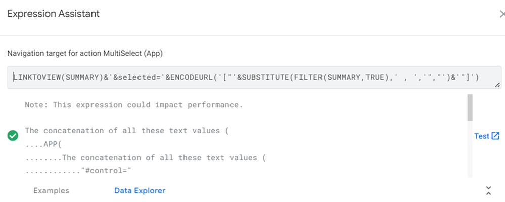

Hi! I am a beginner. Can you please check my expression. What I am trying to do is I want to select all the items listed and delete it. But when I select it, it will not display the selected items. Can you please help me?
Hi @jkevz07 seems like your view "Summary" is not based on any table. Please look for this view and connect it to a table or a slice.
SOLVED NOW! thank you so much!

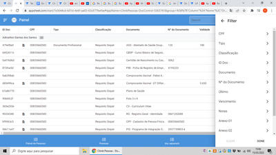

Hey there, Iยดve just set up this button, with a view that has several "Grouped by" conditions. Iยดve reached a formula where it works,  but it takes me to a view where I have to click on those grouped sections once again, and as soon as I click, the selected item goes away. Is it possible to access a filtered view and passing by those "Grouped by" filters? Thanks a lot.
Hi @thematgallery that sounds interesting. Could you post a Screenshot or a GIF of what happens?
@Fabian_Weller  Any idea how to select the filtered view screen data only?
I use a form to navigate to the filtered view and then I need only to select that filtered list (multi-select/select all). the above function navigates to select all the data. Can you help me please?
Hi @Saraappsheet I think you can do this.
Instead of using LINKTOVIEW() you can try LINKTOFILTEREDVIEW()
Or maybe you can use LINKTOVIEW() but instead of the table's name, you could create a slice and use this slice in your LINKTOVIEW() expression.
Please share your expression with us, when you found a way ๐Ÿ™‚

I tried link to filter but it doesn't work. The action button does not appear.
