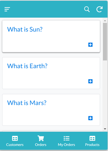

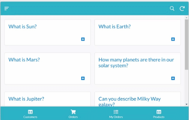

The FAQ page looks like below in tab view
The FAQ page looks much more elegant and useful in mobile view as shown below.

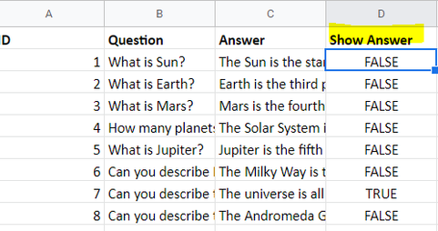

Yes , correct. There is an additional (YN) column that toggles with those actions. That column is used in show_if of answer column. So answer column shows/hides with toggled actions.
In the test app the [Show Answer] column is set to TRUE/FALSE with those toggeling actions.
The column in turn is used in show_if property of the [Answer] column.

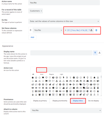

I just tested some things and came out with this:
With this, you don't have to click on the action icon. You can click anywhere in the card.
And you don't need to put the card view in an interactive dashboard to restrict opening the detail view.
  1. Create the Action with the expression IF([Yes/No]=FALSE,TRUE,FALSE) or with the shorter version from @dbaum NOT([Yes/No])
    This Action has no icon and is Display inline.
  2. Set this Action in the Card View as the "On Click" and as the bottom right action.

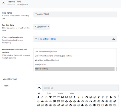

  3. Create 2 Format Rules to show an แฏ Icon when [Yes/No]=FALSE or an แฑ Icon when [Yes/No]=TRUE
