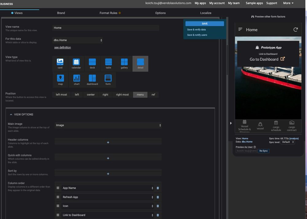

  6. You already may have “view” within you app. Anyway either way, generate “Detail View” out of this table and select “Detail View” at the end. Let’s place the name of this view as “Home”.
  7. Now probably you see the detail view with data you already kicked in. Hit edit and go to edit mode. Upload image file to image type field and save view.
  8. Add one Virtual Column with name “blank” and put app formula " ". Basically this generate null value, which won’t be visible.
  9. Go to view setting. My sample app, it looks like this.
    9.1 : I recommend to set Position to Menu as this should not be frequently used view, but place this whenever you want to place.
    9.2 : Pick your image field for Main Image
    9.3 : Header Columns, select “Blank” column.
    *****Tips : You can place columns, such as App names, name of the site the app used etc into Header columns, rather than putting blank field. When you select fields, then it appears on the landing page. It s your choice and preference.
    9.4 : Column Order, place the fields you put on. Those field will appear within the box which sit in the middle of the view in selected order.
    9.5 : Display mode = Select “Centred”
    9.6 : Image style = Background

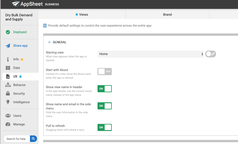

We can set this view as “start view” by going to UX pane, Options.

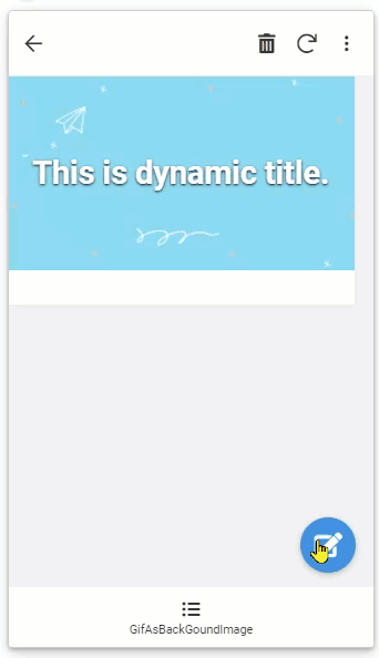

This is mobile view for the same sample. On the mobile phone, we are able to use action to refresh the page without interrupting the use of the app by user. But some app user does not know this option is actually available even though we remind them before. So as additional reminder and guide to user, I added gif image of down arrow like my sample.

One question: Why do you need the [Blank] column as a header?
Hi Fabian,
Sorry not to mention to it. Good question indeed.
Trick is simple.
When we leave nothing column selected for header, the box which sit in the middle is going to be pushed up, which looks bit ugly to me. In order to push the box downwards, place blank column. Actually blank column is exist on HTLM but actually not visible to us as it is kind of null.
See the 1st screenshot below, the result of inspection of the page. Actually header element is existing on HTML but it is not visible.
See the screenshot below to see how view is going to be looking like when we leave header section untouched.
If the box overwrap oddly with the background image, we can move the box position up and down by adding blank fields as I explained.
If we place the box at the bottom like my sample overlap with the image, hiding main object, then we may place the box at the top by leaving the header section empty (no column selected)
It is depending on what sort of image or gif file you would like to you and position of the box will be contrasted with your image. User decide the best location, by adjusting box by selecting blank fields or nothing selected.
Actually we can place any column to header. Then this is another sample how it looks like when we add App Name for instance to header.

In terms of Gif images for Appsheet, I m playing around with it, using like an animated banner like this. Set gif to image header for detail view and add another text column to turn it over to dynamic banner?
To generate gif file, i found Canva is actually useful.
https://www.canva.com/pro/animator/
Once we create the animation, then download as GIf and push into Appsheet.

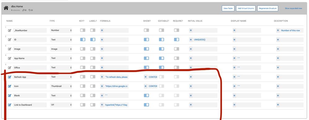

Hello bro Koichi! I appreciate your clear instructions here and you’re doing awesome with your custom landing page view.
I’m still a newbie here, and Im trying to make a custom landing page by following ur instructions.
But, I face problem here.
I create a table same as yours, using one row, containing a data like image, appname, icon, etc.
Then,
In View option, When I set the image/gif as the background, a big box is shown and covering my entire image.
And yes, of course I’ve put a virtual column (“blank”) as ur suggestion. I set it as the header column, and like u’ve said above, there is some space and push my column (like appname, etc) to bottom.
But the problem is, they wont display it like yours. The small text box containing appname, icon, etc isnt showing. It’s still showing a big box, with my data column pushed to bottom, but covering my entire image. Would u help me?
Not exactly sure where you are doing wrong, as it is relatively easy set ups.

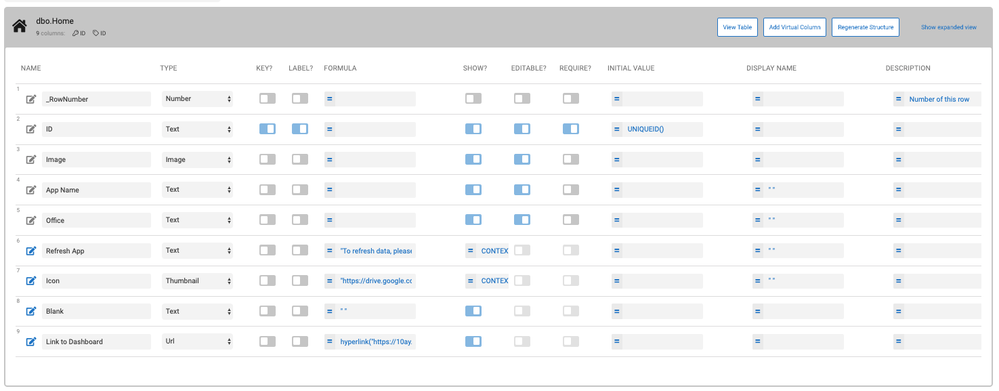

This is a screenshot from my apps, which may help you to compare with yours to find a point for correction?
According the image from your column setting (Which i’ve marked with red), I have some questions:
  1. Are those column are virtual columns?
  2. In “Refresh App” and “Icon” column, there is a formula there (context…), can you show me that formula? I reckon I missed that formula.
I’m sorry for troubling you a lot bro.
Have a nice day!
It is not questioned the column is physical column or virtual column, it does not matter.
You can attach any action you want into any column, poistion is inlined.
Maybe if I can access your app, I can deep dive more and learn the configuration. But it seems, I cant access / copy and customize ur apps.
