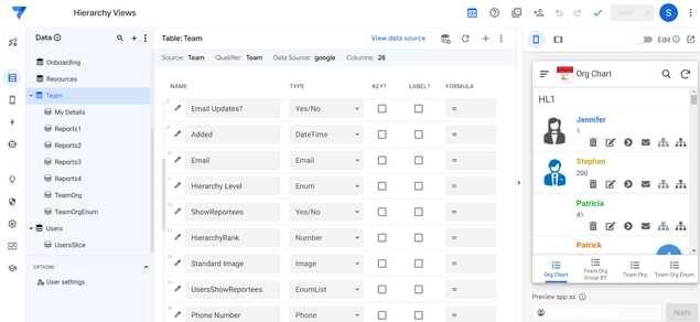

The below tip implements the hierarchy view using a table view, of course with some limitations listed below. The main idea is to selectively show the table rows based on user selection.
The tip basically visually extends the concept described in the "Team Directory" sample app (https://www.appsheet.com/templates/Teammate-contact-details-and-shared-resources?appGuidString=7ffea... ) to make it more presentable in a single view. So thanks are due for the concept of self referencing to the creator of sample app "Team Directory". I have used that sample app to modify further.

Please use the icons in the first column ( as highlighted below) to expand /collapse the organization of a name.
Principle
Show More
Principle: The sample app and the app in the tip has a table with  a column called "Manager" that is a self reference to itself.  This helps define the hierarchy structure. Of course the tip has many added functionalities ( actions, slice , format rules and some images to visually construct hierarchy structure through connecting lines)
When the user taps on the the inline action in a row, that row is selected or deselected ( by setting a column in that row). This set/reset column in is used in the slice  to select/deselect the children rows  where the parent ( or manager) row has been selected.  The table view based on slice then presents the org structure by showing those selected rows.
There is some additional work to include images in different image columns as per hierarchy level so the org level structure is visually shown. These images also include the (grey connector lines  อฐ) that show up suitably depending on level and selection.
Link to  1 minute demo videohttps://www.loom.com/share/07ee449861fb425e98d782141be575c9
A screenshot of the Org chart from the app:

I noticed the HierarchyRank column, it seems like it's the one making all the magic stuff.
I think that your trick would benefit from hiding that column and just making it sort based on it on the view's config.
Also, I think that we can't prevent users from sorting on just one table, it's applied on all of them. This view would benefit from a "prevent sorting" on each view that's table viewtype. If it's not a feature request about it, I'll make it
Hi @SkrOYC ,
Thanks for your insights. Yes, you are correct that [HierarchyRank] columns decides hierarchical structure. Yes, it is correct that one should hide that column in actual implementation. Just retained it for the demo app.
Yes, you are correct about sorting of table issue being univerally applied to all the tables. My thought would be to use another app that just shows this Org structure by reading just the required underlying table(s) and preventing sorting on it.
Thank you for your just the right analysis. Appreciate.
