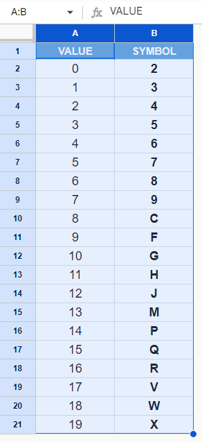

Create a 2-column table from the value and symbol info from below GitHub page below, import it as a Read-Only table to your DB, and name it as you like,i.e., PLUS:
https://github.com/google/open-location-code/blob/main/Documentation/Specification/specification.md
Your table will look like this:
"Plus" Table"Plus" Table

For any address-type column you have, you can use the below AppFormula to create a 10-digit Google Maps Plus Code:
CONCATENATE(
	LOOKUP(MOD(FLOOR(((LAT(HERE())+90)*8000)/160000),20),"PLUS","VALUE","SYMBOL"),
	LOOKUP(MOD(FLOOR(((LONG(HERE())+180)*8000)/160000),20),"PLUS","VALUE","SYMBOL"),
	LOOKUP(MOD(FLOOR(((LAT(HERE())+90)*8000)/8000),20),"PLUS","VALUE","SYMBOL"),
	LOOKUP(MOD(FLOOR(((LONG(HERE())+180)*8000)/8000),20),"PLUS","VALUE","SYMBOL"),
	LOOKUP(MOD(FLOOR(((LAT(HERE())+90)*8000)/400),20),"PLUS","VALUE","SYMBOL"),
	LOOKUP(MOD(FLOOR(((LONG(HERE())+180)*8000)/400),20),"PLUS","VALUE","SYMBOL"),
	LOOKUP(MOD(FLOOR(((LAT(HERE())+90)*8000)/20),20),"PLUS","VALUE","SYMBOL"),
	LOOKUP(MOD(FLOOR(((LONG(HERE())+180)*8000)/20),20),"PLUS","VALUE","SYMBOL"),
	LOOKUP(MOD(FLOOR((LAT(HERE())+90)*8000),20),"PLUS","VALUE","SYMBOL")
	LOOKUP(MOD(FLOOR((LONG(HERE())+180)*8000),20),"PLUS","VALUE","SYMBOL")
