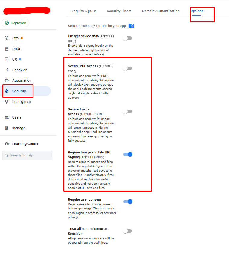

Here is a setup that I have using this print service. Note that this requires one to disable the security options that allow public file URLs from Appsheet.

There is nothing I can add that is not already in the initial screenshots.
Have you disabled the security options for files?
If you canโ€™t open your file URL in a separate browser window (best to test in a private browser session), then printnode canโ€™t open it either.
Ya, it is disabled. Shall I disable the Require Image and File URL sigining too?
