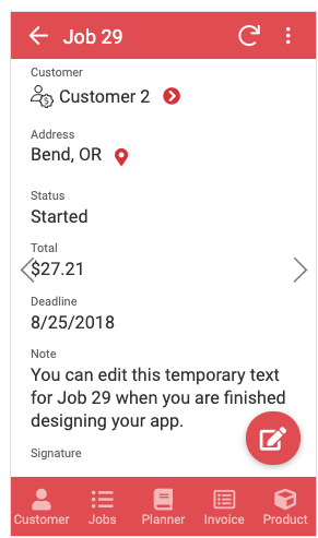

Detail Views show all the columns stacked vertically, which leaves a lot of wasted screen space.

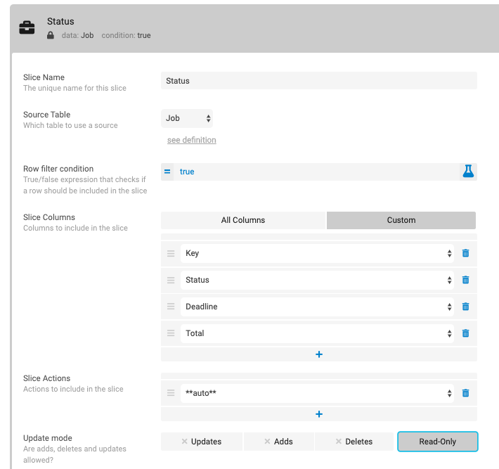

Make certain columns display in a horizontal list by creating a slice, and a virtual column:
  1. Add slice, select the columns you want, also add the Key column.

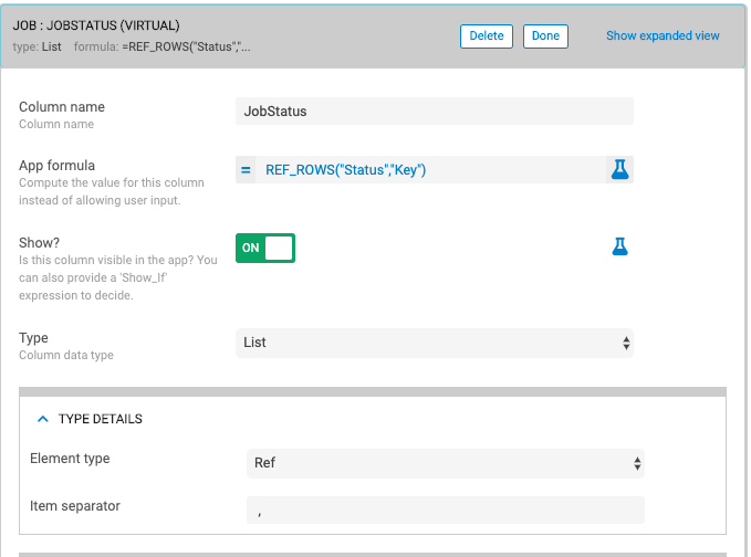

  2. Add a Virtual Column: REF_ROWS(โ€œSliceNameโ€,โ€œKeyColumnNameโ€)
    this relates every record back to itself, with the child being the new slice with limited columns
  3. Replace the individual columns on the detail view with the new virtual column.

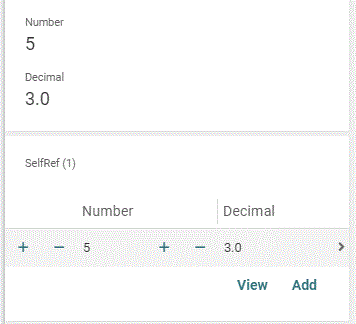

Another use case:
A clever and useful trickโ€ฆ Thanks @GreenFluxโ€ฆ

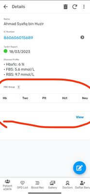

Thanks for the tips this is a very efficient way to show datas. Btw i plan to use it for a data that is optional. How can i hide the horizontal list if theres no data entered in that field?

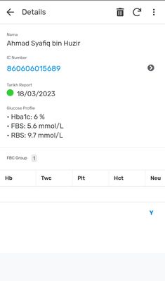

And also i tried to hide the VIEW button using this:
CONTEXT(โ€œVIEW โ€)=โ€˜Blood Data Menu_Detailโ€™
But it now it shows "Y" on the view button.
Any idea how to remove those? Thanks a lot for the help.
