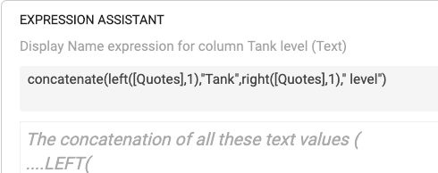

In formulas (expressions), AppSheet doesnโ€™t distinguish between directional quotes (left and right different) and straight quotes. So, until now, I havenโ€™t been able to use directional quotation marks in column names and in concatenate() expressions. Today, however, I hit upon a work around.
First, I noticed that AppSheet had no trouble with the directional quotation marks that I put in cells of my Google spreadsheet:
So, I decided to add a column with the left and right quotations marks
and then invoke them with left() and right() expressions:
Iโ€™m quite happy with the result:
Itโ€™s a fair amount of work, though. So, if anyone knows of a better, less complicated way of doing it, Iโ€™d be happy to learn about it.

At least this syntax works with column namesโ€ฆ โ€™ " โ€˜&โ€œNameโ€&โ€™ " โ€™ I added extra spaces so it would be easier to see.
I tried it but it came out looking like this:
I think the AppSheet interface sees both curved and straight quotation marks as the same character (or maybe I should say โ€œconverts all curved quotation marks to straight onesโ€). I think my work around may be necessary after all.

I see. Iโ€™m not sure what I did wrong. I was, however, able to get the more complicated method I described to work. Iโ€™ll try again later but at least I have one method that Iโ€™ve been able to get to work.
One way isโ€ฆ LEFT("""", 1)
Hmmm. Still having trouble. This method also produced a straight quotation mark. Iโ€™m not sure what Iโ€™m doing wrong. I appreciate your help though. Thanks for your trouble.
