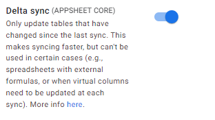

Today I noticed this:
Of course, the fact that the Delta Sync option will be ignored for tables that use a security filter is a "feature," not a "problem" in my case.
