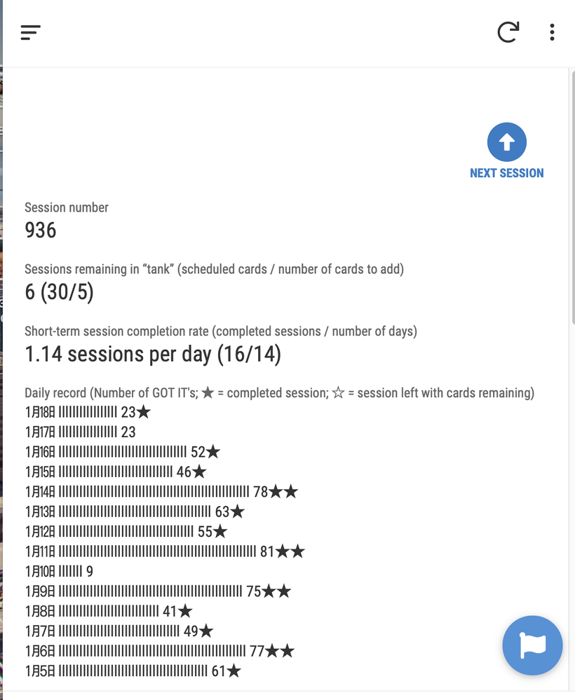

The [Number] in this case is something that has just been changed by the user. So, AppSheet “knows” the current value. The [Session no copy] is a column that merely reproduces [Number] via the Google spreadsheet. In the spreadsheet, [Number] is J2, and [Session no copy] is “=J2”. The result is that [Session no copy] will not equal [Number] until the sync is complete. In other words, AppSheet won’t “know” what the new value of [Session no copy] is until the sync is complete. Hence, instead of displaying incorrect numbers, my app displays the following:
Then, when the sync is complete, AppSheet sees that [Number] and [Session no copy] have the same value and so it displays that the calculation, which is now correct:
By the way, the bars, numbers and stars representing the amount of work done each day are another example of something I was able to put together on Google sheets but wouldn’t know how to do on AppSheet. Notice that the data for January 18 (1月18日) changes after the sync.
