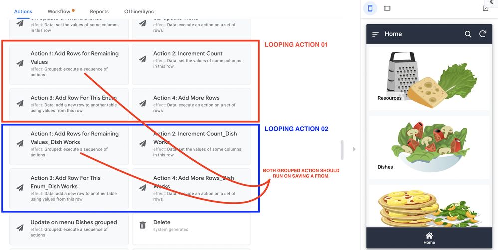

I am not able to achieve it using actions because i have 3 tables to updated in parallel. If i attach the action on save it actually worked for one table or one set of looping action. I have multiple sets of looping actions.
I m not sure what your exact requiremet will be, but should be achieve with action only. But set ups is surely complex though.
Itโ€™s very simple. Here is an example.
