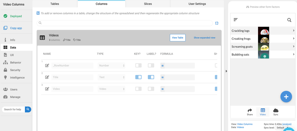

Where do I set up video embedding?
The ability to embed your videos in your app is done by ensuring your data is correctly set up to accommodate and display videos with the right column types. We’ll walk you through the process of how to do this below.
  1. To find the portion of your data where you’ll need to make adjustments for video editing, open your app editor by selecting the app you’d like to work on.
  2. The navigation bar on the left side displays a tab titled “Data." Click this tab.
  3. Once you’re in the data tab you’ll find a navigation bar along the top of your editor. The second tab is the “Columns” section. Click this tab.
  4. Once you’re in this tab you’ll see a list of tables. Select the table you would like to have associated with video embedding.
  5. From here, select the data column that you would like to contain the embedded video links and confirm that the column type is set to videos.

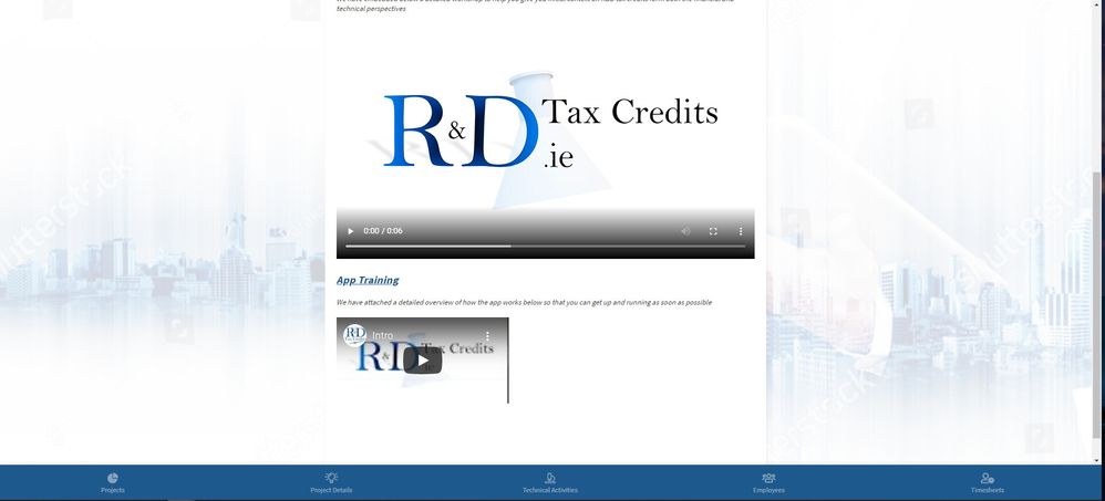

Looks nice though, here is a detailed view with a vimeo video on top and a youtube on the bottom.
The picture in picture feature is pretty good too, if you were embedding an instructional video in a long form or something like that.
Awesome, I wish it was the same layout for YouTube.
